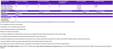

Could you enter your full address below and copy and paste the notes below the table

It's SR204. Does that mean the engineer needs to run the fibre from the street, alomng the driveway to the house and drill? @cookiemonsteruk

The notes in the link i gave will detail how they plan the install

Thanks @cookiemonsteruk see above for the screenshot, can you help me decipher it please?

Once mdu shows on an install multiple dwelling unit the internal work should already be done

Thanks @cookiemonsteruk sorry do you mean the tool shows no further work involved?

As far as i can see the building is already set up via a underground cbt to a internal consumer splicing point csp nad 2-4

Thank you @cookiemonsteruk yes the building already had Sky wired in.
So apologies for asking again, what will they actually have to do upon installation?
