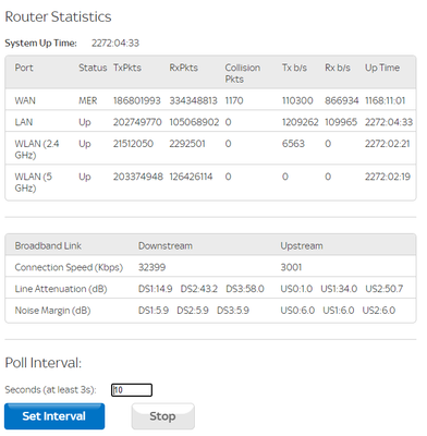

@CarlHickman1976 Could you please post your router stats following the link below.
Message posted on 15 Aug 2024 06:45 PM
Re: Sky Broadband Superfast is Slow
Hi - As requested, here is my router stats.
Any additional help would be greatly appreciated.
Message posted on 15 Aug 2024 07:13 PM
@CarlHickman1976 your router has been running for nearly 3 months so is over due for a reboot - all electronics benefit from the occasional restart.
Overall your line looks healthy the connection speed of 32Mb/s looks roughly right for the apparent length of the line while it is not performing spectacularly well it is within the usual parameters.
