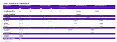

BT stats

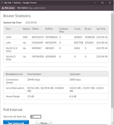

Router Stats
looking at the bt info , it looks like my line is capabale of 60 max so no way i can ever achive the guarantee download speed stated in my contract.

@Jenny81 What is the minimum speed that you are supposed to get on your connection? Looking at your router stats and also the BT wholesale information would think that you are under what is expected.

@Jenny81 Well going by your router stats only seeing less than half of that.

An analysis of the router stats shows you should be getting a faster speed than one is getting unless there is aluminium en route to the cabinet, I put the distance at about 800 metres from the cabinet and the noise margin isn't showing any room for improvement so only an engineer doing major work would be able to improve the situation by doing a likely lift and shift.

I say that 64.8Mbps would never be achievable on that broadband line, only about 50-55Mbps maximum with major work because the noise margin is at 3.5dB which shows it is a noisy broadband line owing to a major issue or aluminium broadband line. If it is an aluminium broadband line and a lift and shift cannot bypass it, you are stuck.
And the handback speed of 35Mbps is correct for 800 metres to the cabinet but you are below even that speed, so work needs to be done. You have effectivily only got 2 bands in play D1 and D2 with those attenuation figures which gives an absolute maximum of 55Mbps.
