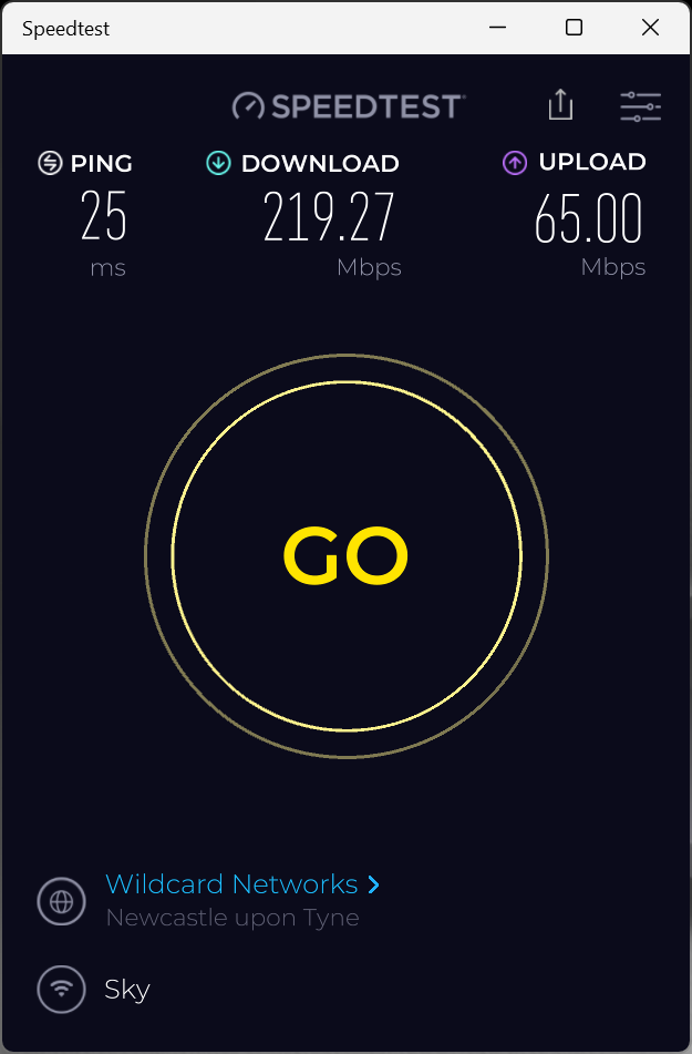

@sidestick Have my SE210 parked away in its box from years ago, will hook onto my Asus RP-AX58 which is sitting in repeater mode and see what i get on the FF500 that i have as a speed test later and post that result for you. Jim
Edit:- 2 speed test 1st on the SR203 direct wi-fi, 2nd on the Asus RP-AX58 which is repeater on the SR203, Asus was busy as daughter was streaming 4kUHD movie and the wife was on her laptop you tubing as normal so will get a capture later when they are all off it, life would not be worth living if i asked them to get off it know what i mean.... Picures you will see when they get approved.
SR203 direct on its wi-fi
Asus RP-AX58 linked to the SR203 in Repeater mode and busy with other connections

Jim - your testing is really appreciated - especially finding and scrabbling about using your old SE210 !
At least the "capped at 150 Mbs" I read is not true - you got 219 Mbs so that's great !
If... at a family quiter moment ... V difficult I know (!) --- you could run the test again sometime without any other major load on the AX58 / SR203 that would be really great 👍.
