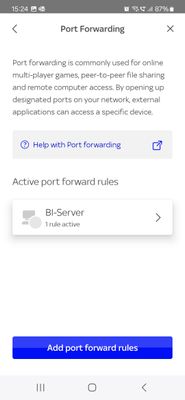

Sky hub has no facility to add Port Forwarding as it states the Sky app is used for this

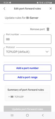

In the Sky app rule has been applied to my BI Server as It is called:-

Re: SKY MAX hub and Port Forwarding
@Noopy66
Have you confirmed its only TCP your server needs and not UDP as well? The Windows firewall looks to be configured for TCP only.
@jamesn123 tried TCP and TCP/UDP both failed.
