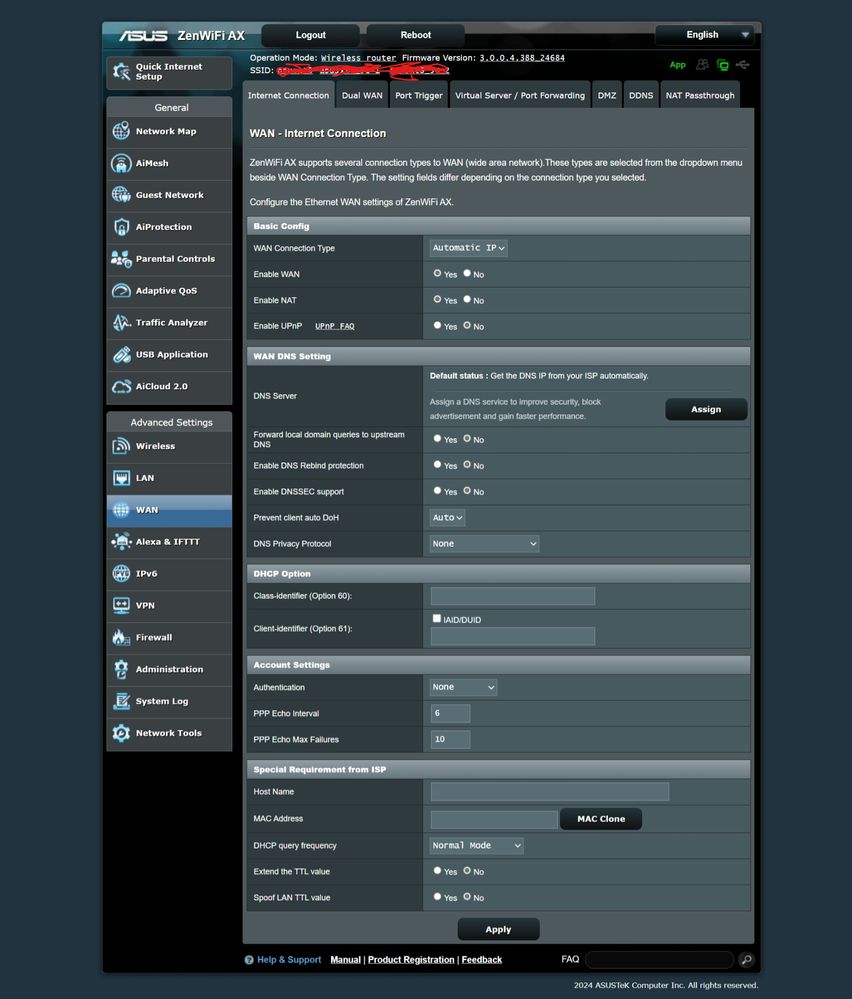

Before posting this, i have searched this forum high and low for answers to no avail.
Ive come from virgin media which allows modem mode. Sky doesn't.
I would like to use my router due to current poor WiFi range and more customisation on my network.
My router is asus RT-AX82U v2 and I have fttp
Steps ive taken:
-plugged my router into the ONT box directly.
-Set my router in wireless router mode,
-enabled option 61 and set username as anything@skydsl|anything
-I dont have option for vlan so ive had to put 101 in "VID" under IPTV settings in router
I live in UK so I wouldn't be using a pppoe connection as far as I understand.
My router reports that there is a problem with dhcp and I cant connect to the Internet.
Ive switched off the ONT  and router for 30 minutes and tried again but its not helped.
Please could anyone provide advice?

@Frezli Get rid off the vlan!
Asus wan setting may help you!Asus wan setting may help you!

@Frezli Pictures will get through once they are cleared, based on my XT8 but will be very much alike settings wise!
Please note that i am not using the option 61 parameters as do not require through my fttp connection!

Your advice worked. Thank you
All the posts I could find were saying add option 61...
deleted the option 61 as you mentioned, removed vid 101 from lan > iptv and it works
Copied your settings in the screenshots which were very helpful
