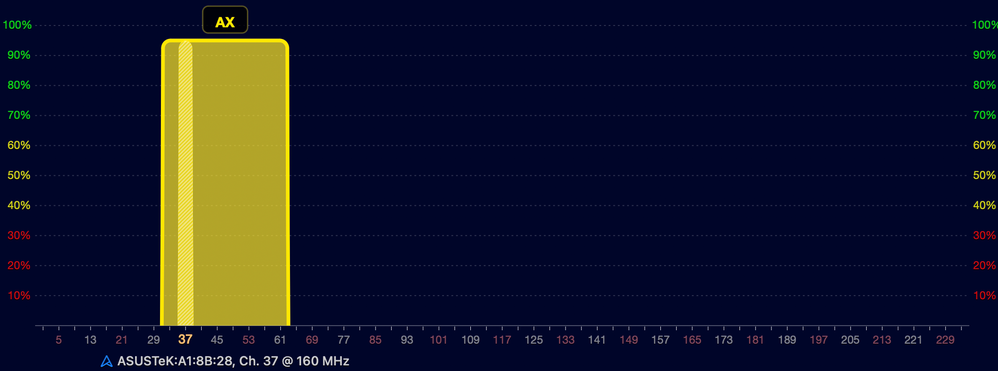

I have an option to enable 160Mhz bandwidth (no idea what that means), but when I turn it on and try to save settings it gives an error "2.4Ghz fronthaul SSID is the same as the backhaul SSID". Can't immediately see a way to change individual SSIDs.
That seems to cover most of the options in the app (there may be more if I access the router itself). I've seen fixing channels mentioned, I would guess I'm currently set on an 'auto' select. Is this worth playing with and how would you know which is best to use?

With more nodes that are close by and wireless then 6GHz backhaul is better because the 6GHz backhaul isn't impacted by DFS channels (meaning that radar cannot impact signals)..
With DFS channels which are most of the 5GHz band radar is the primary user and home wireless on 5GHz is secondary.; this means if radar is detected then the router must switch itself off or move the channel, so you have a loss of wireless using DFS when the radar is detected or anything that even closely looks like radar which is usually another wireless router in some cases.
The backhaul over 2.5Gbps ethernet will reduce the latency very slightly but is mainly for local use and moving information between the nodes at two-half times faster than 1Gbps ethernet, it requires good cables and I suggest category 7 flat ethernet cables.
The width of the channel the larger the better, eg: 160Mhz allows more traffic the wider the better like a motorway.
Radio on three bands, eg: 2.4Ghz, 5Ghz-1 and 5Ghz-2 for XT12 only 1 of the 5Ghz-2 bands can go wide for backhaul, eg: 160Mhz wide like a motorway.
