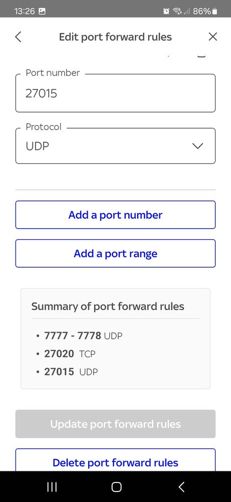

Message posted on 16 Apr 2025 04:07 PM
Re: Port forwarding to a desktop
Just thought I'd attach these showing the software listening on 7777, the firewall being open and the port forward rules from the app showing they're forwarded.
Just spoken with one of their live agents who decided it needed to go to tech supported and said someone would get back in 1-2 days, but if anyone has experience here and there is an easy fix let me know.
