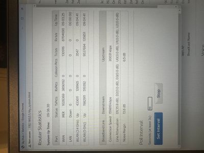

@AP1985 if you have a black Sky hub post is connection stats as they should show what is going on see Sky Hub statistics

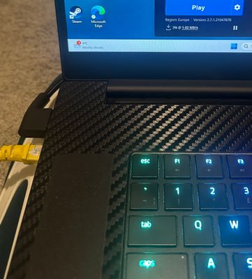

You can see in the top right of this picture the speed I can download at with a wired connection.

@AP1985 The hub's stats show a healthy G.FAST connection running at over 150Mb/s which should give a download on a device connected by a gigabit ethernet connection of roughly 135Mb/s after allowing for overheads. Not sure what app you screen second picture shows but run a test on speedtest.net or fast.com to see what they tell you.
