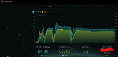

The Wifi is standard, I've made no changes apart from the Wifi SSID. When connected, the average speed is anything from 50Mbps (and no, I've not made a typo, I mean 50) up to a maximum of just under 300Mbps. I've tried adjusting the channels but no meaningful improvement is made. The connection is unstable and frequently times out on multiple device types (we have WinTel laptops, Android phones, and Apple iPhones and iPads). Right now I'm sitting 3 feet from the router now and this is what I get.

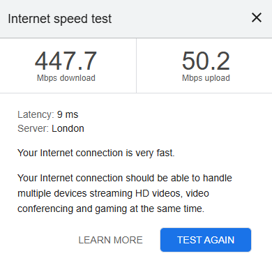

If I attach another wireless AP via cable and setup a totally standard wifi network, this is what I get:
The new AP is a TP-Link Archer AX12. Nothing special but gives relatively good coverage throughout our smallish 3 bed house. The Sky router and new AP is centrally located. The irony is, our older Sky router connected to the copper based broadband gave significantly better signal quality and coverage than this new one. So three questions:

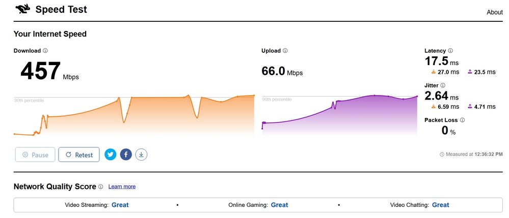

And just to add, just run another speedtest on the Sky router Wifi.
This is connect on the 5Ghz channel with speed of 488/780 (recieve/transmit).

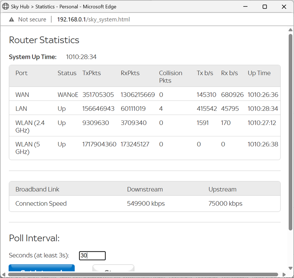

@se151 That is tosh my SR203 hit's 500Mb/s on wifi connection with no problem what so ever, and i even have Asus routers that were hanging on it in router mode. Couple off screen shot's attached from back in April when they clear for you to view.

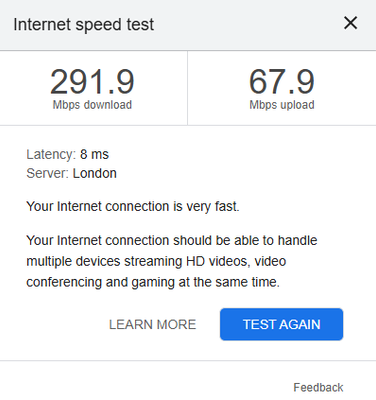

I can hit 500Mbps with the TP wifi that is cabled to the Sky. No issue there. I can top 500 connected via cable straight into the Sky router, again no issue. But Wifi, no chance... Even with 2.4Ghz shut down on the Sky router, max connection speed is under 300. I've used multiple diagnostic tools to establish where the fault is but there is no logical reason why it's slow, but also cannot understand why it drops out or freezes.
As I type this, my laptop is connected via 5Ghz, transmit/recieve is 866/650. But speedof.me reports a download of 112, peak at 213. Google speed test is 79.3. If I switch over to trusty 'ol TP link, 473 download... However this Sky router manages the wifi connection, that seems to be root cause and I cannot see a fix.
