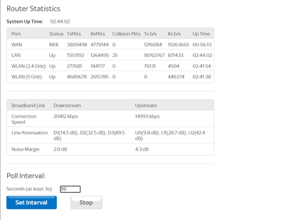

after checking forums this is my router statistics page
from that screen what would the community say is the issue for the slow speeds?

Your noise margin downstream is to low however your line attenuation is fine. Possibly indicating an internal fault as you should be getting probably over 60Mbps

@Storminorme If you can say also what do you have connected on the Lan as from your post all the data is via Ethernet connection and collision happening somewhere along the line.... See if packet collision is rising over the next couple off hours in normal use.
This is also in addition to @cookiemonsteruk 's observations, but it sure looks like you have a line fault that needs some fixing...

I have been watching the router statistics page and the noise margin downstream you mentioned is bouncing around all over the place very odd
