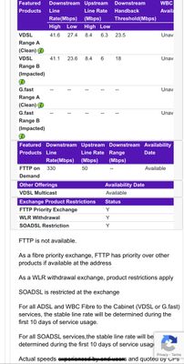

Is this what you wanted me to post? I cropped out the address info at the top, assuming the rest is safe to share.

@Pabs2 which shows exactly why Sky ordered a partial copper service as the FFTP line is "on demand" which means no fibre is laid to that address and standard full fibre cannot be ordered. The comment FTTP not being available is pretty clear.
Quite how there is a fibre line to the property in fact is a mystery. Is there an alternative address? Was the engineer referring to a non-Openreach connection perhaps from Virgin Media or some third party network?
Ordering from another isp will access the record you have so is pointless.

honestly, I am totally lost here. I can see from that table that it clearly says fibre is unavailable, but like I said, I was already under that impression anyway prior to the engineer call out.

@Pabs2 this is a total one off personally I would leave it with Sky to get this sorted as no other isp can order an Openreach full fibre service based on that record. The ONT will bear Openreach branding if it is one of their's if so how it got there is a mystery unless there is an alternative street address for the property as the record you posted shows no fibre infrastructure available in the road.
