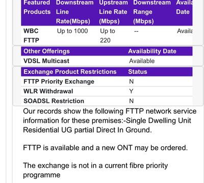

Thank you for getting back to me,
annoyingly it won't let me print screen but the two sentences after the table say
"Our records show the following FTTP network service information for these premises:-Single Dwelling Unit
Residential UG partial Direct In Ground.
FTTP is available and a new ONT may be ordered."
the table as follows :
Featured Downstream Upstream Downstream Availa
Products
Line
Line Rate
Range
Date
Rate(Mbps)
(Mbps)
(Mbps)
WBC
Up to 1000
Up to
Availa
FTTP
220
Other Offerings
VDSL Multicast
Availability Date
Available
Exchange Product Restrictions
Status
FTTP Priority Exchange
N
WLR Withdrawal
Y
SOADSL Restriction
N

@Grac2 post the whole table as a screen grab and include tge first two or three lines of the notes.

@Grac2 still only a small part of the table but the notes indicate that the new gibre feed comes from the road underground and will be directly buried in the ground ie there is no existing duct carrying the okd copper cable they can use.
In this case normally a team who handle ground works from Openreach have to dig a slit trench and bury a thin duct from the pavement point to your property which may cross your drive and then make good. Once the  duct is in place a second team runs the fibrecable through the new microduct and installs an external plastic box where the street cable terminates and to be connected to the internal feed to the ONT unit in your home. My own install was similar and took multiple visits hopefully your's will be smoother than mine but expect a few weeks delay.

That's the issue underground cable direct in ground
the current copper service is a buried armoured cable with no ducting so the delay is while open determine the best way to supply and fit the new full fibre cable
