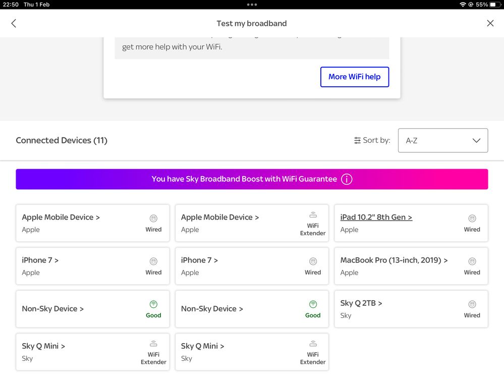

We have an ongoing issue with broadband since our switch to ultrafast. We had no issues for years on sky Superfast.
I have an open case with sky, but just noticed something strange when testing via the sky app. Some devices are showing as wired when they are not. We only have our sky q box connected via Ethernet . Can anyone shed any light on this......

@Stu_B i wouldn't worry about the issue with device indentification as that is often a bit odd quite why isnt clear. The impoortant thing is the device is working.
If you would like advice from forum members who are customers like yourself on the issue with your Ultrafast connection please post some details. Normally Ultrafast connections which use full fibre are far more reliable than Superfast over copper unfortunately thst doesn't always apply to Ultrafast over copper lines which a few customers have.

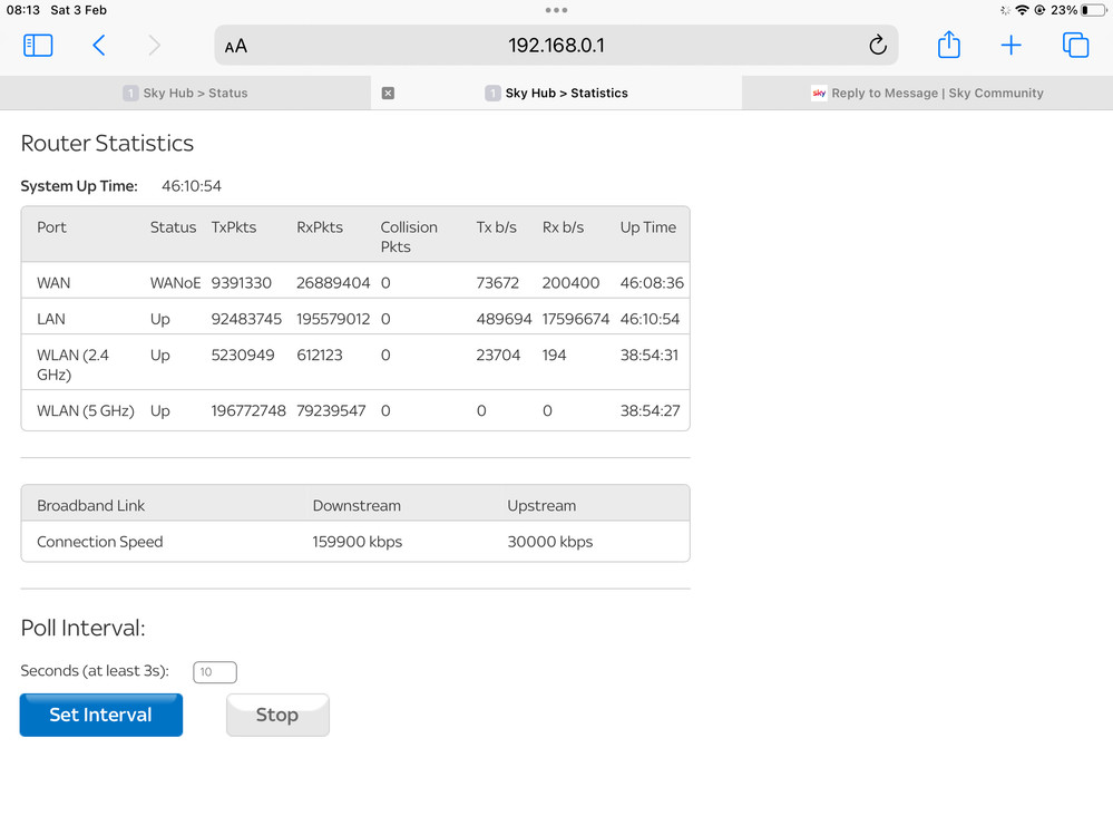

@Stu_B that is interesting could you post your hub's stats as explained here Find your Sky Broadband router statistics
The issue those may show is a number of "collisions" recorded. If there are a significant number could you try disconnecting the ethernet lead from the main Q box and see if that makes a difference.

@Chrisee Thank you for the response, I post back tomorrow with the router stats, along with what I've already tried in a attempt to improve things.

@Stu_B you system is not showing collisions so I tend the think Sky msy have a point with wifi signal level. . Is there any kit that uses wireless like a DECT cordless phone or wireless speaker base station near the hub? If so move them a few feet away?. Do the drops in connection coincidecwith another event like someone using the microwave or turning sometging on or off?
You can check for interference from other wifi networks by using an app called Wifi Analyzer on an Android phone or a windows laptop which will show all the SSIDs within range with their signal strength and channel. Two signals on the same or adjacent channels will interfere..
Another useful app is Wifi Sweetspots which also works on iPhones which shows in real time the speed from the device to the hub as you move round your home. I found several dead areas when I used it which i sortrd by a combination moving the hub and the device higher.
