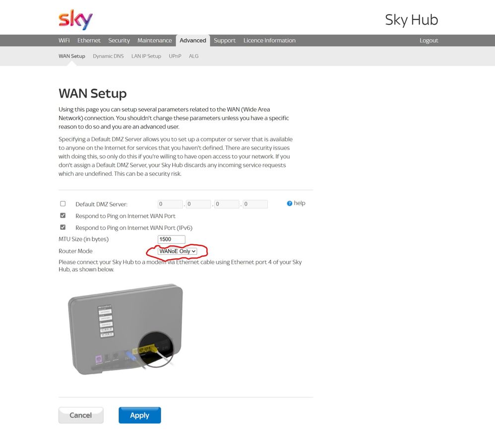

@DebSteve There was an OP posted few months back the ONT / SR203 took 20-30 minutes to wan connect on boot up, did not believe that so got him to change the WAN connection off Auto, you will see the picture linked below when it get's cleared for viewing, after that he was on the standard 4-5 minutes, straight green on the Internet and connected at that point!
Sky SR203 off the Auto to WANoE always connection!
