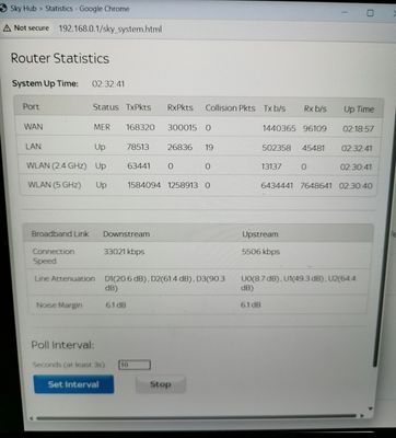

Hi, I have the sky hub 4.2 connected to the openreach master socket pre filtered. There have been no changes there. I've tried 3 sky routers and all give the same fault no Internet at all or around 0.5mb-1mb average. All lights are green on the router even when the Internet completely drops off. I'm connecting via ether net to laptop and desktop and also WiFi and all give the same problem. I'll try post up the hub/router stats now. Thanks in advance for your help

Will take a look when the pictures get cleared for viewing, they have to be checked before they are released so it's not an instant for anyone else to see them. Has your OR Master socket been swapped out at all during the multiple sky Hub supplies to you?

Re: No Internet sky have ran out of ideas
Nothing much wrong with your stat's and showing you currently have a larger up/down than you are posting!
Do a speed test and at the same time watch that screen and see what the wan part is doing out to the Internet, you 5Ghz band is busy but hard to say what you are actually doing.
