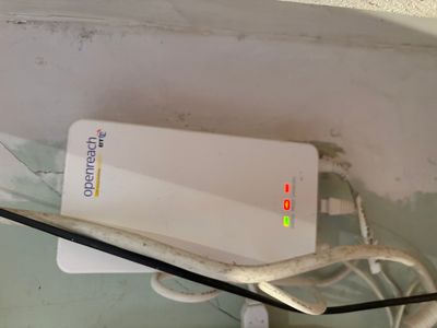

@IanW11 Have a look on the Brown packaging box that the hub came in, say what the first 2 letters numbers you see are for the serial number and UK or ROI location! Black/White hub, copper fttc or Full Fibre fttp service!
Message posted on 02 Jul 2025 02:35 PM
Re: New customer no broadband!!
31 UK white hub full fibre I think
Message posted on 02 Jul 2025 02:58 PM
@IanW11 Not sure about the serials for the white sky Max hub, (D2 for UK DE for ROI but that is for the Black Hub), if you have Full Fibre then you will have a small white ONT box connects via a RJ45 cable Ethernet, AND no matter wether white or black and on a FTTP then you have to use the VERY right hand Ethernet port viewed from the back off the hub and it is marked as WAN.

@IanW11 NO it is Port 1 on that ONT from BT that you have and Port 4 on the back off the sky hub.
Port 4 light that you have on, was the BT ever plugged in to that? Not the way that unit is normally used!!!!

**bleep** as simple as that!!! Even sent pics to sky and Openreach!! Now appears to be working. Thank you so much

@IanW11 Link to also get your batteries changed out red lights on you BBU picture.
BT Openreach Fibre ONT - How to replace Battery Backup Batteries for phone line - YouTube

@IanW11 The flockers never even looked at your pics then!
