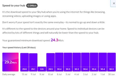

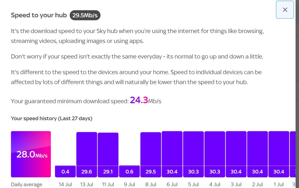

@JimM1 :
I think the engineer used a 3rd party speed checker since he had logged into my wifi (sky max). Just checked 0.5m
I don't believe the average are correct these days, max maybe ...
