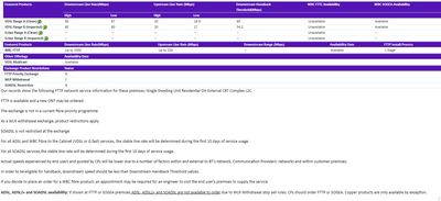

Thanks @Timmy.  Here's an image of the complete table:
With my limited understanding of the tech, it looks like the BT line is available for Sky, but does this mean the best Broadband connect I could expect from anyone except for Virgin is 80Mbps?

My eyesight isn't quite up to reading that on my phone but it appears FTTP is available with some kind of caveat on the installation.

So gigabit broadband is potentially available through new overhead fibre optic supply but it's not a straightforward job to get in place.
That's the 'OH External CBT Complex L2C' bit.

As it's not a fibre priority area an Openreach ISP could in theory sell you FTTC over copper, but I don't think any will now do so because they are incentivised to help get the national switch to FTTP moving.
