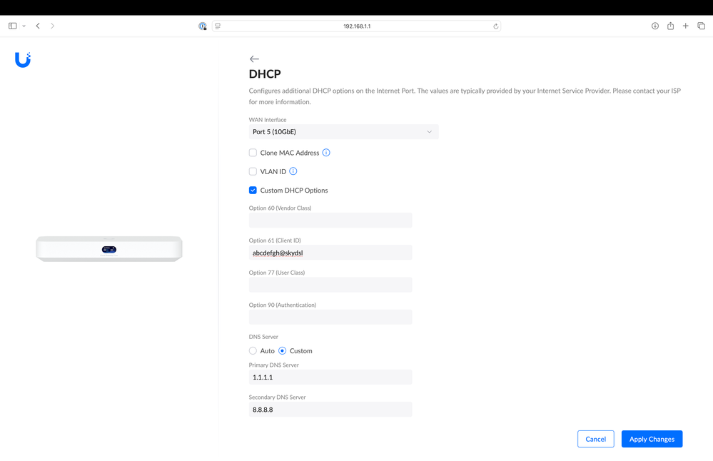

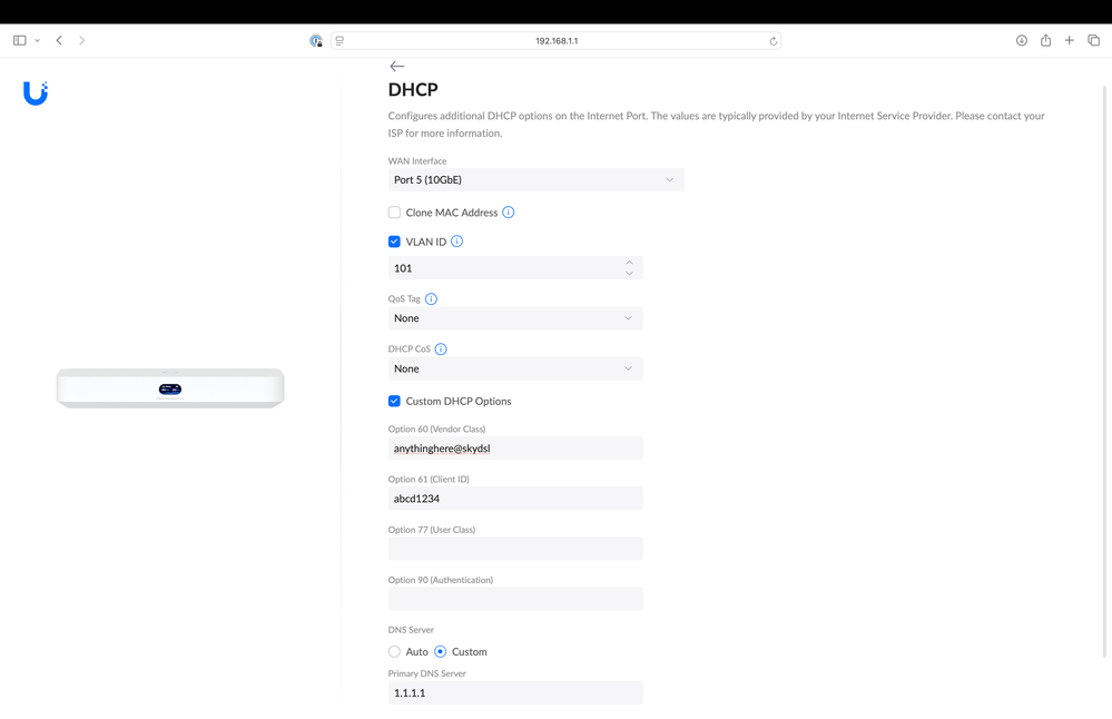

3. I tried multiple combinations in the Unifi console: set up Option 60 but not 61, set up just 61, set up both, VLAN tag, no VLAN tag. None of it worked.

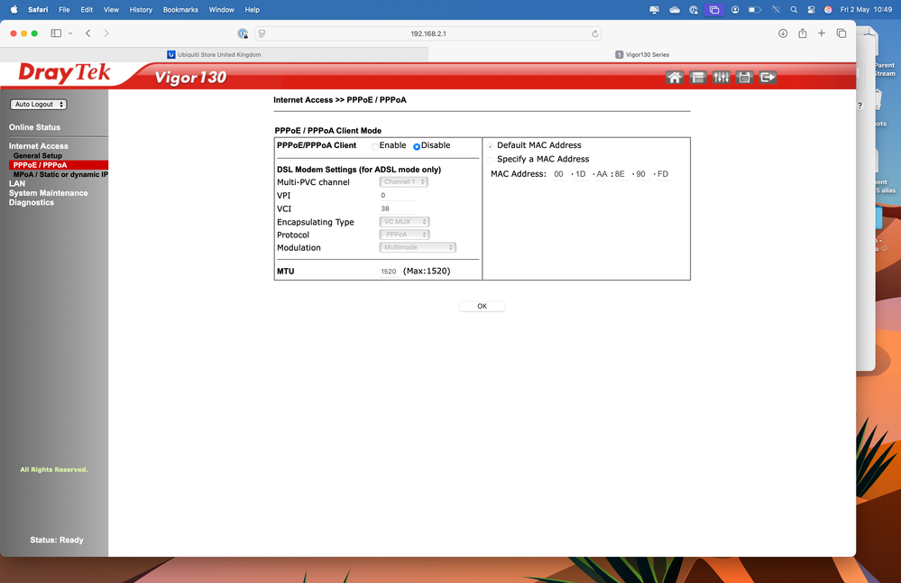

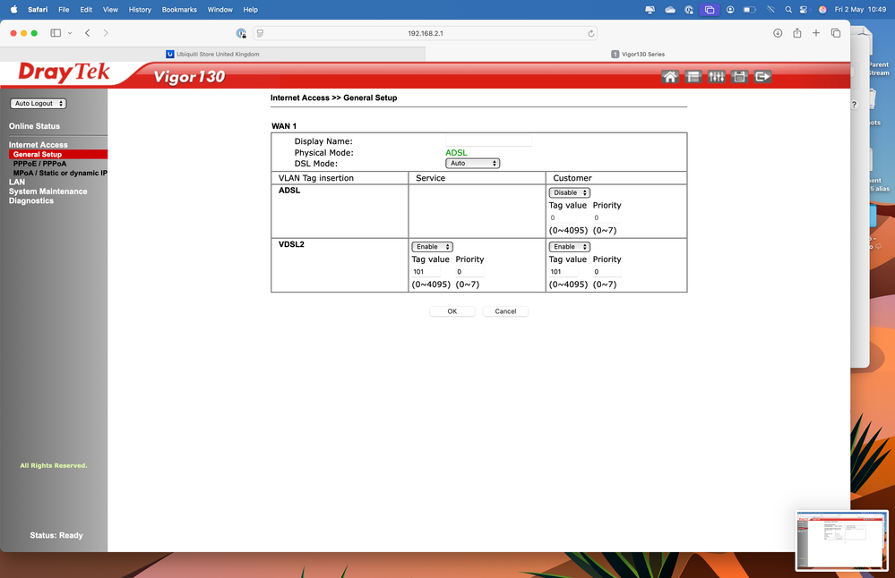

4. I reasoned that maybe I could put the parameters into the Vigor. So I did a factory reset and tried to configure the Vigor correctly. It wasn't obvious but the things I changed were:
  > Set VDSL2 for "Customer" to 'Enable' (it was previously disabled)
  > Made sure PPPoE was disabled
  > Ensured Bridged mode was set

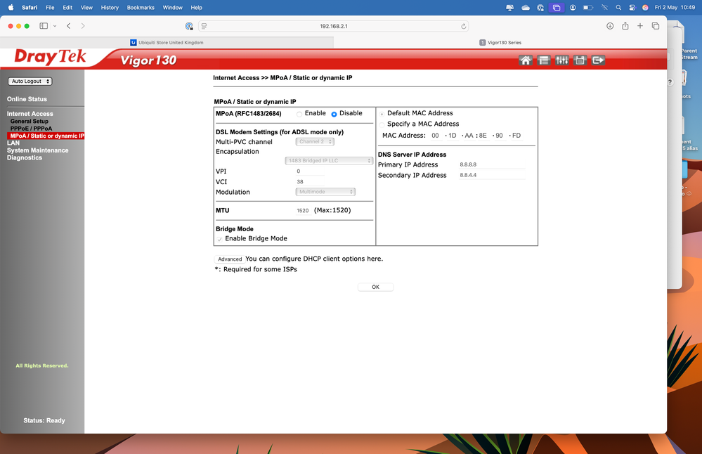

  > In the Static/Dynamic settings, went to 'Advanced' and there I had the option to configure DHCP Option 60 and Option 61. In the Vigor you have to ADD these as DHCP services/options one by one (i.e. you add Option 60 then you add Option 61).
  > I tried to save the options and it gave me an error saying I had not provided the "data". I noticed there was a field at the bottom that said you should provide data for each of the options. Since I only had one thing to provide (the generic "login credentials" provided by @GD1) I put anythinghere@skydsl  in the data field for Option 60, and abcd1234 in the data field for Option 61.
  > Then when I saved it, I seemed to lose the ability to access the modem through the WAN port, I think related to the bridge mode (but it should still work as I had configured my laptop with a static 192.168.2.x address).

@Alastair_M  To use the DrayTek Vigor 130 modem with Sky Fibre Broadband, either with a DrayTek Vigor router or another manufacturer's router, set up the modem in Bridge mode. This allows the modem to pass-through the DHCP information to the router connected to it. The router connected to the modem needs to be set up for DHCP option 61 to receive an IP address from Sky.
You need to use Dynamic IP or similar in your router, there also needs to be a place to populate DHCP Option 60/61 details as below:
Option 60 anythinghere@skydsl
Option 61 abcd1234
ASCII character should be selected

And the VLAN is 101 not 110.

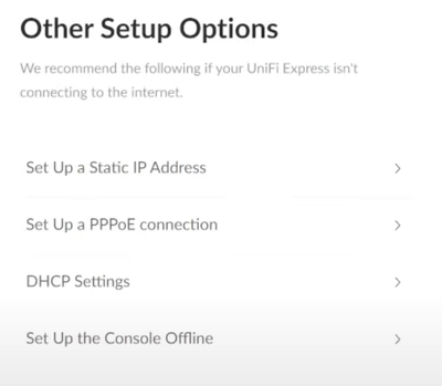

@Alastair_M  No you don't use PPPoE as that is not what Sky use,  it's got to be Dynamic or Static IP.

Oh ok. Thanks. The image below shows the options I'll be presented with.
So I guess I will select DHCP instead of PPPoE and look for references to MER and/or Option 61. Most of the other params I either know by now or can probably guess!

1. There are lots of videos online showing a UCG being connected to a DSL modem in passthrough / bridge mode and the DSL params being set up in the Unifi/UCG device so I assumed this was what I would do. You can see from the screenshots of the Unifi console that the options are indeed there to configure Option 60 and Option 61 DHCP.
2. Since I was expecting to configure DHCP in the Unifi box I didn't pay too much attention to the configuration of the Vigor 130 other than to check it was in bridge mode -- it was.
