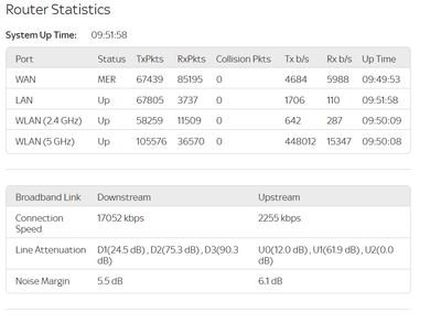

@IT2 Once you picture posting is cleared for viewing will take a look, it is not an instant for all others to see!

@IT2 Looks like you reset or the hub did it just over 9 hrs ago, nothing alarming on the stat's, and you are up now at 17Mb/s 2Mb/s Down/Up rating, when did you say you changed or the service was activated!

@IT2 No way that I know how and what method that your line is connected to by/inside your home, if you are direct on a OR Master socket type 5c is the best, the older master socket via a hanging or plugged in ADSL filter, or even connected to an extension socket, can say you have a very long line from your home to the green cabinet connection, with the required 10 day's leave it alone and let it try and work out what is best and get to it's optimal working.
But your stat's show everything that is there, no hiding that fact, up 09:51:58 since the last and what i would say either switched off/on or the FW update push to your hub....
