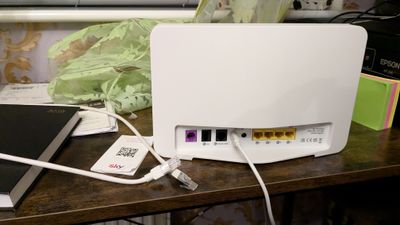

Attaching some photos below:
The whole package that arrived with Sky Max Hub: new modem, ethernet cable, main supply cable, installation guide.
All the sockets on the new hub - the small circular male socket in the middle is where Im supposed to be connecting the cable.
Closer look.
The squared male Openreach cable from the outside that was connected directly to the old modem, and should be connected to Openreach internal box.
The slot on the old modem where it was directly connected to before.

The green fibre optic plug can only connect to an optical device such as an Openreach ONT: it does not (and cannot) plug directly into a Sky Hub or any other ISP router.
I suspect what you refer to as the 'Openreach BT modem' is the ONT: there are several different models. This connects to the Sky Hub over ethernet cable (into the fourth yellow port, marked WAN)
The circular connector in the Max Hub is an alternative power supply point.

That 'modem' must be an ONT of some variety though, otherwise it wouldn't have an optical port.
A picture of it (front, ports and rear) would be useful.
