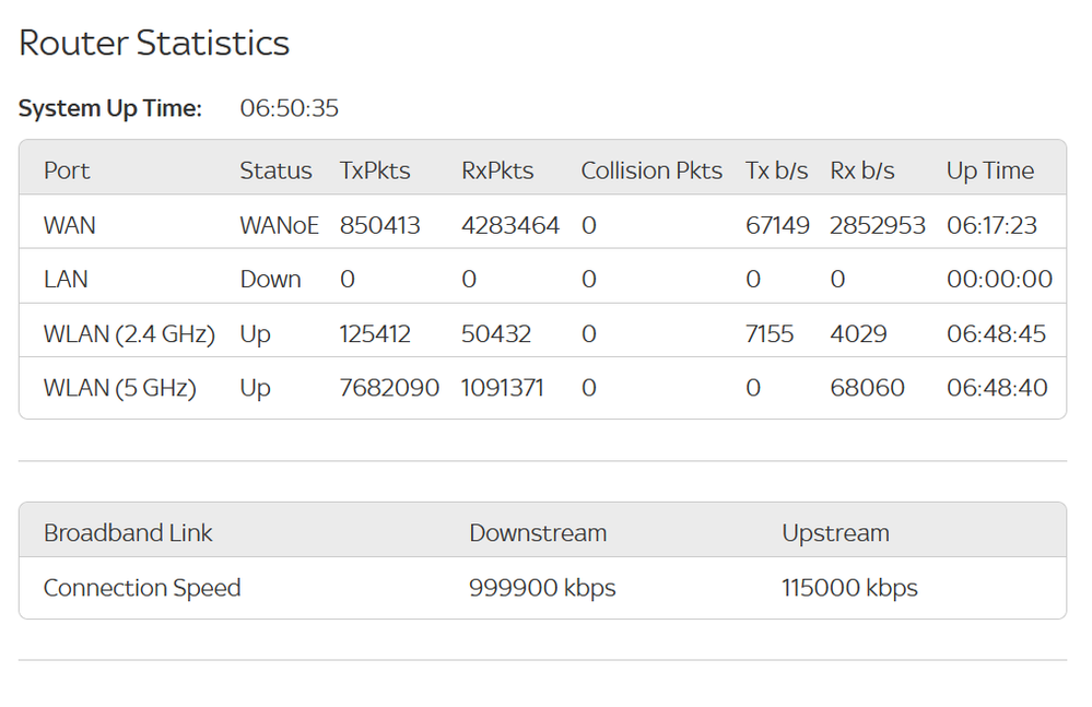

Hi,
I ordered the Sky 900mbps full Fibre Gigafast package, and had it installed today.
The Sky Fibre Broadband tests say everything's fine 696Mbs to the Hub, but independent speed tests from speedtest.net, fast.com, Xbox, etc are much slower at 190Mbps.
I'm plugged directly into the Router using an ethernet cable. Does anyone know What's going on?
Stats below
Message posted on 23 Oct 2025 08:19 PM - last edited: 23 Oct 2025 08:27 PM
Re: Low Sky Full Fibre Gigafast Speeds, Help?
@Ravski Your stat's are fine and indicating the hub is setup correctly, is your PC good enough to run the test?
Stat's are also showing that you are NOT connected to the hub as Lan is 0 all the way, and NOT usual to show that, 5Ghz can be flaky at times but have never found the lan to be off at all for reporting!
