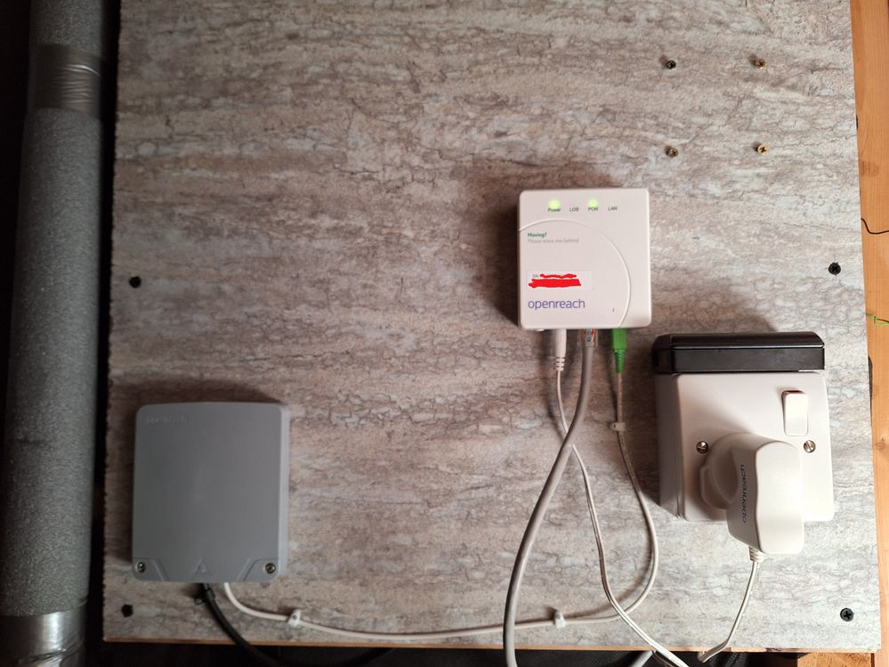

This sounds like a full fibre to the property installation the fibre optic cable comes from the telegraph pole to the box outside the house then from the box to the inside to the optical network terminal box like the 2 photos here
and then the cable from here to the router, I have had this since January last year, sky gigafast full fibre broadband 900mps and have had no problems

@DK0904 The outside grey box called the csp is where the External fibre comes from and the splicing point for the Internal where A joins B.
There are a few In/Out methods, but yes 1 In through the inside off the Box out to the Inside off the house, and there is NO hard and fast rules what is best or needs to be done, I had OR bring the Fibre direct off the pole to the roof then straight up the roof truss into the dormier and the csp is fitted there inside see picture below, Ethernet cable from the ONT then away to the Wan port of the hub, where i wanted to place that for the location. Only Fibre cable is absolutley NO sharp bends they have a minimum radius for the cable to help the light travel best.
Internal for all Fibre CSP/ONT
