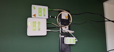

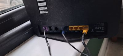

Hi. There's three cables attached to the router. One is a black Sky plug, another is the yellow one that's connected to an existing Internet connection (house was pre-wired), and the third goes directly into the white box.
I'll attach photos.

Personally I would start by gently removing and reinserting each of the two green jack plugs (optical fibre connectors) in turn.
Message posted on 10 Aug 2025 09:04 PM - last edited: 10 Aug 2025 09:37 PM
Re: It seems painters unplugged the "Do Not Power Down" plug.
And I'm confused about why there's apparently no ethernet cable between the ONT and the Sky Hub.
The cable connected into port #4 on the Hub should probably go into the ONT, not that wall socket.

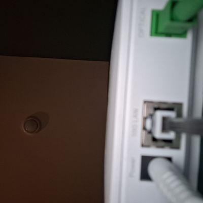

The image appears to show a telephone cable plugged into the ONT, which typically wouldn't be correct.
I'm wondering if the whole setup was completely disconnected and has been reassembled rather unwisely.

@TapDance Yellow plug that is in the wall, take it out, then plug it into the box on the wall with the green lights on it underneath like the other cables, the socket is just left off the green connector, just be carefull when you do it!

@TapDance The purple connected cable it is not used, so if you have it going to that white box with the green lights get it out off there!
Take that connection out with your last picture you posted, that is where the yellow plug goes!

That white jack plug appears to be incorrect: it's RJ11 (telephone connector) jammed into an RJ45 (ethernet) port, which is why the fit is so imprecise.
You need to remove it and make the correct connection, which is the other yellow ethernet plug from the cable going into port #4 on the Sky Hub (which seems to currently be plugged to the wall socket)
Connecting ONT to Hub over ethernet should wake up the broadband again: you'll then need to resolve connection to the rest of the house (I'd think another separate ethernet cable between any other ethernet port on the Hub and that wall socket), and then landline telephone (if any) which goes from handset to the Italia/RoI phone port on the Hub.

The yellow cable is already in port 4 of the router.
