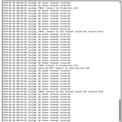

Ping from Computer to Router fine, Tracert fine. Try 8.8.8.8 and nothing. destinantion unreachable.
Noticed in the logs that ACS Failed: Could not resolve host.
Noticed in the logs that the NTP Request to ntp1.isp.sky.com or ntp2.isp.sky.com fails. Logs are stuck at 1970. Does this mean the router thinks its 1970 and therefore won't ever connect?
I have an external IP address, but can't ping it from internal.

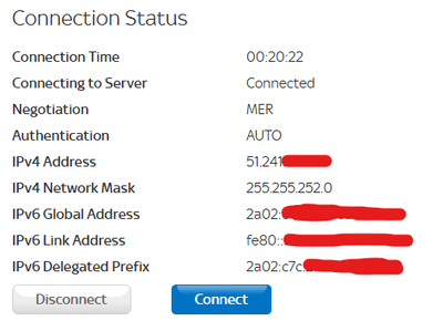

This is the connection status, but as I said, no internet:
this was after I rebooted it. Again.

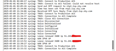

finally:
Might be a routing issue? That's from my mobile phone tethered to my PC.
Message posted on 09 Mar 2025 10:30 PM
Re: Issues with Sky Hub router ADSL > 3 out of 4 green lights (Voice Amber, don't use it) No Inte
its a miracle! Its started working! Hurrah!
