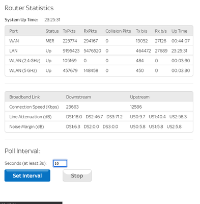

Here's my router statistics if that will help.

Your downstream speed is too slow for what it should be on your line. Your stats are also missing the values for noise margin on DS2 & DS3 so certainly a line fault. You'll need to get Sky to book an engineer, either we can escalate your post on the forum to chat with a Sky rep or you can call which may be quicker.
