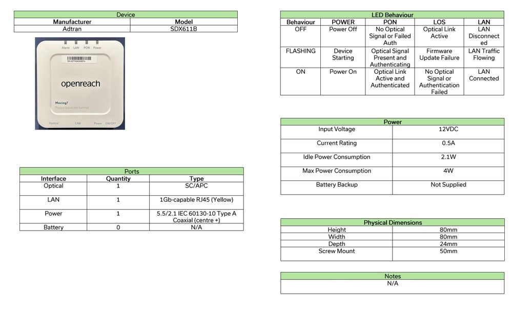

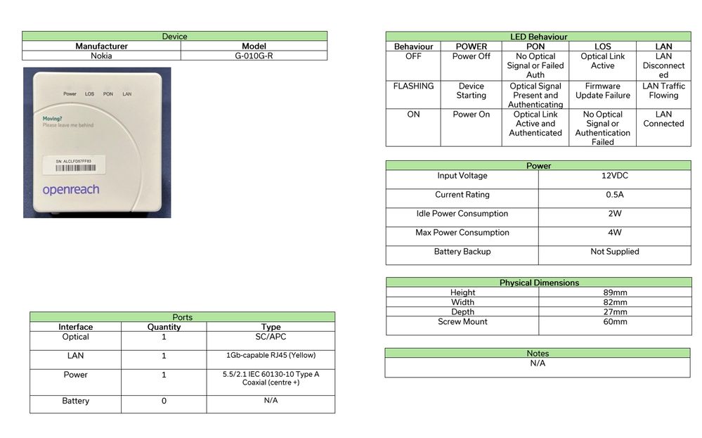

@Jab93 The ONT that was installed then Power and Pon solid green lights on it, the Lan will flicker as data is sent from the hub to the ONT....
The ONT lan cable Ethernet goes to the back off the SR203 Port 4 also marked as WAN an the very furthest connrction on the right as you look at the back off the hub!

I have been looking at the ONT and the router at the same time and I think it's a ONT problem because every time the router goes amber the ONT at the same time turn off PON and LAN and the power light start flashing then PON goes red a few seconds before turning green and on and on again. any ideas ? Is there a line for openreach to call them or should i go through sky first ? Thanks
Message posted on 02 Aug 2025 07:09 AM
Re: Internet issues on the first day of activation
@Jab93 You have to call sky to address the issue with the ONT, they will organise for OR to look at it and do what is needed.
That will be the issue when installed part of the check for OR was to ensure that the ONT was powered, FW update to it was applied and it was matched to the system ID on the network. The ONT is having a problem links below and i will do both as unknown which one you have.
Adtran ONT for OR connection
Nokia ONT for OR Connection
