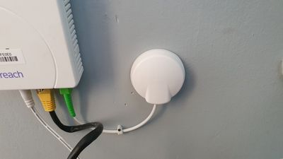

Our ONT is around 30cm from top of the enclosure to bottom of the optical pigtail curve (which does have a minimum bend radius)
To be mounted low on a wall it would really have to be upside down, which is technically possible but aesthetically unappealing.
