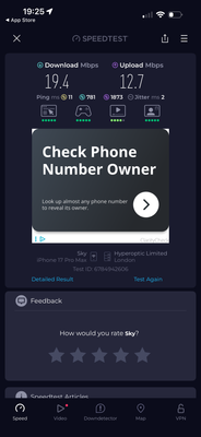

This is speed test I have just done on my phone from Ookla, unsure why it's so slow.
@JimM1 do you have any suggestions?

Re: Installation of Sky Full Fibre Gigafaat
@BTx555 Your two values on that picture off 781 and 1873 the are rubish for speed!
