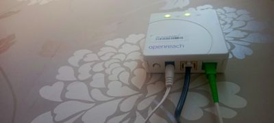

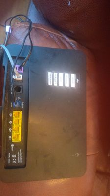

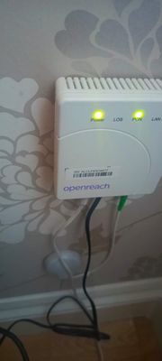

I moved from house to another and I notified Sky that I will move, on the 10th of September I received a text that my sky broadband has been activated, I hook up my broadband equipment to the open reach port in my new house but didn't work. I have tried to trouble shoot the gadget with open reach online guides
but yet don't work. I have a not been able to use my broadband for the past 4 days now. I think I Will need an engineer to come and fix it for me.

Have you told sky that you have full fibre ?
Message posted on 14 Sep 2024 11:25 PM
Re: I moved from Birmingham to Taunton and I notified Sky that I will move, on the 10th of September
As that is an optical network terminal you have there, they may not know that at sky

@Ade78 you should have been sent a so called "conversion kit" by Sky which is a simple ethernet cable so unplug the black cable you have and connect one end of the ethernet cable into the ONT box on the wall and the other into the yellow socket numbered as 4 on the Sky hub - there will have been instructions that came with the cable.
If for some reason Sky have not sent you the kit either give them a call or buy a simple ethernet cable locally.

@Ade78 You need to take out the cable that you have connected to the middle port on the ONT and that is going into the router. As @Chrisee says you need to connect an ethernet cable to the ONT in that same port then into port 4 which says WAN on the router.
