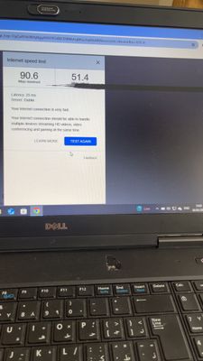

COuld you please post a screenshot of the speedtest you completed via ethernet?

Re: I’m getting 10% of the speed I’m paying for even when I test with an Ethernet to router,
I'm not sure how to do that on here.
@JamieG1 thst speed test result is consistent with a 100Mb/s ethernet connection are you surectge connection supports Gigabit speeds? Check the network settings on the device.

Hi, even when I'm right by the router I can't get anything above 50-60mb/s on WiFi and when I go up stairs it's 20-40 mb, I was getting faster speeds previously when I was on a lesser deal. Something isn't adding up. It's a cat5 cable so I wasn't aware they're limited in capacity to 100mb/s I can try a cat6 ether net see if the results any different tomorrow.

I agree with @Chrisee that it looks like your ethernet speed is limited. You need to use a Cat5e or above cable as well as ensure your laptop has a 1Gbps ethernet port

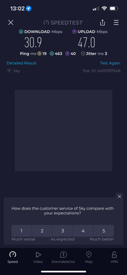

speed at the router.

Hi all, I have sorted this issue, it was my own stupidity surprise surprise...
I separated the 2.4 and 5.0ghz networks to allow smart devices on to the networks, when I combined it to one network again (I was connected to 2.4ghz) it is now at proper speeds. Sorry and thanks for your help.
