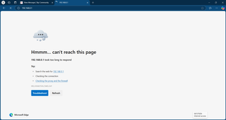

Hi,
im trying to login to my Sky Hub SR-102 Admin page but when i type (192.168.0.1) it says it cant be reached!
can anyone help?
Kind Regards,

Re: I Cant Log-In To My Sky Hub Admin page
Are you using powerline adapters, wifi extenders or switches by any chance? It seems like a third party device on your network is causing the issue you see. In rare circumstances powerline adapters in your home can also get intertwined with a neighbours network of electrical wiring is poor.
Remove all Ethernet cables from the back of the router, keeping one to run directly to a PC if required, and unplug any other network devices.
Hard reset the router by holding in the reset button on the back for 10 seconds.
As already mentioned that router is pretty old and I would enquire about a replacement. However, if the root cause of your issue isn't found and resolved it's likely that it would carry across to any new routers installed.

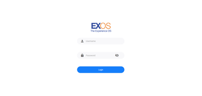

it says default gateway is ((192.168.1.1)) but when i type that in it comes up with experience os

dont know what exos is
@lewlew92
That suggests another device on your network is issuing IP addresses.  A Sky Hub would not give a 192.168.1.1 gateway by default.
EX OS is an operating system.
https://www.calix.com/press-release/2017/10/calix-introduces-exos--the-experience-os--empowering-ser...
which would appear on various bits of (American) hardware
https://www.calix.com/products/platform/unlimited-subscriber/gigaspire.html
