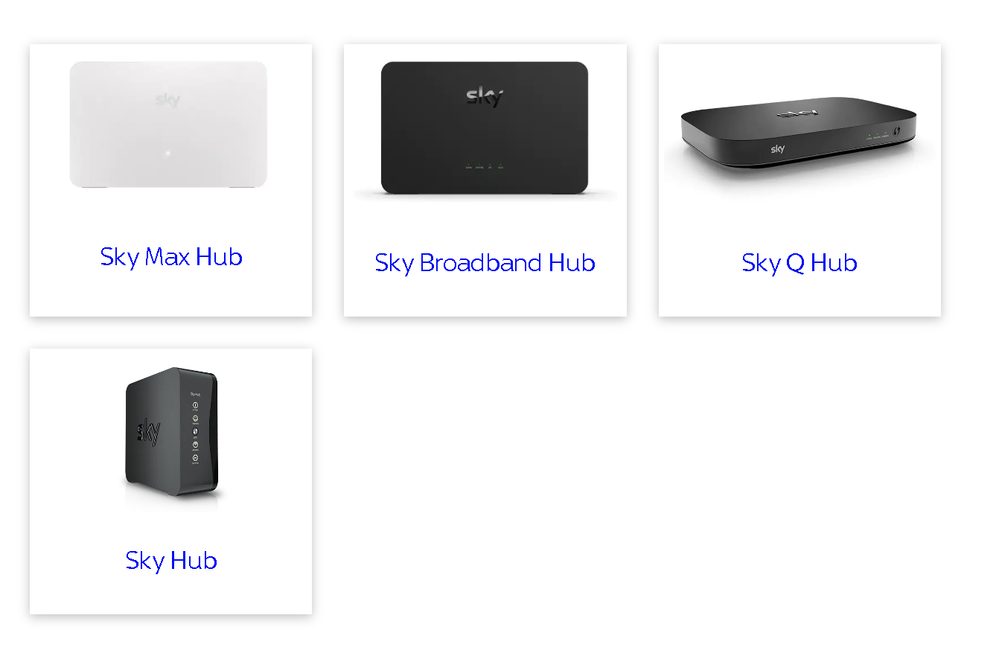

By default all current Sky Hubs broadcast on both 2.4Ghz and 5Ghz simultaneously.
Which model do you have?

@PadraigMc given Sky Broadband doesnt use the satellite dish that your Q box is attached to not sure what you mean,
To connect cameras that wont connect to a dualband SSID you either need tomsplit the twombands which can be done on the black Sky hubs by following these instructions Split Sky WiFi bands
The white Sky Max hubs dont allow tgat instead using the My Sky app you temporarily turn off tge 5GHz band then connect the cameras then turn the 5GHz band back on and the cameras should stay connected.
