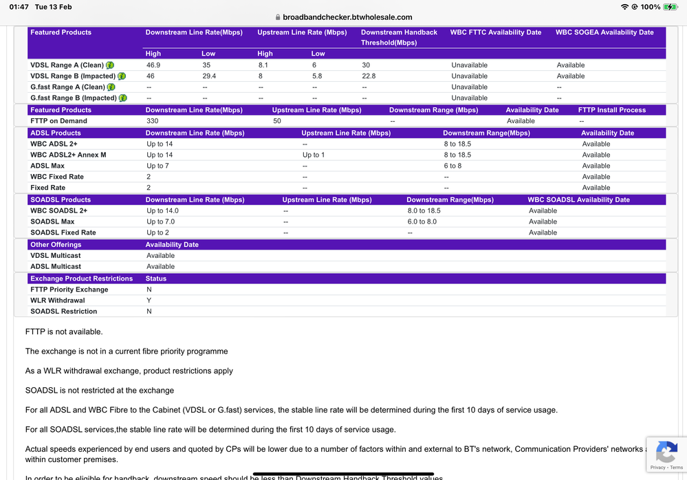

Re: Higher cost for slower broadband?
@steved1970
Putting the address into the BT Wholesale Availability Checker should indicate which provisioning type is applicable.
Avatar for steved1970
This message was authored by: steved1970
No idea what that means 😂
@steved1970
That the wholesale checker it will give us an idea of what speed you should get

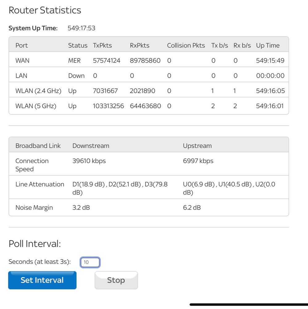

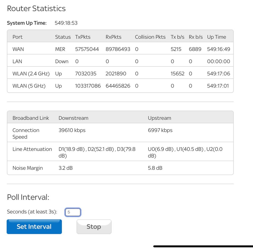

How do I know where and how far away from the cabinet I am?
@steved1970
That shows a maximum of 46 Mbps and a handback threshold of 30Mbps this is the figure isps use to set their guarantees.  So either openreach have lowered the speed profile of your line or the cabinet you think is supplying you actually isn't.
Could you post your hub stats
@steved1970
Your stats may indicate how far you are from your cabinet via the line attenuation figures
@steved1970
As @cookiemonsteruk indicates, you have been provisioned on a 40/10 Mbs service ('Superfast 35') because the wholesale supplier can't guarantee a speed that would justify an ISP charging a subscriber for an 80/20 Mbs service ('Superfast') : this does save you some money.
Until FTTP infrastructure is installed locally to you, that's very unlikely to change. The current target is to have full fibre available to 85% of UK addresses by 2026.
Hopefully I've not shared anything I shouldn't.IMG_8791.jpegIMG_8792.jpegIMG_8794.jpegIMG_8795.jpegIMG_8796.jpeg
