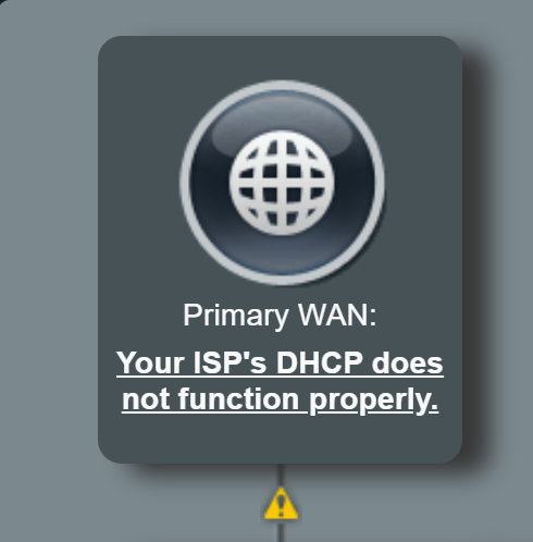

Hi @Chrisee I have entered DHCPv4 Option 61 "anything@skydsl|anything" that got it working but iam not getting the full speed.

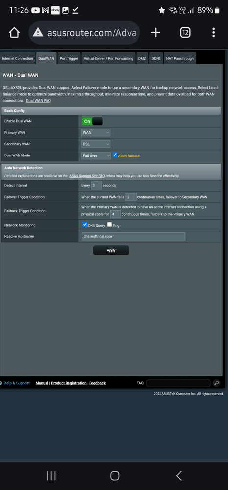

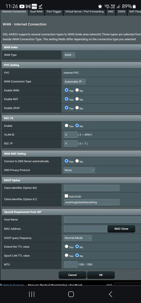

Ill put some pictures up if someone can see if something is wrong.

In 802.1q enable vlanid and type in 101

hi @cookiemonsteruk just tried that now and the internet will not connect and I have rebooted aswell.

Try disabling dual wan i assume you only have dsl connection. If you have a 4/5g dongle for failover then set dsl to primary
Also set mtu to 1500

@cookiemonsteruk so turned off dual wan and set MTU 1500 so that's all working but still only 9MB download speed.

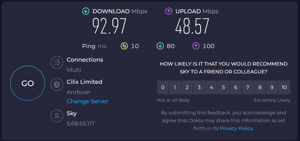

i have tried speed test on the mobile app an still the same speed.
