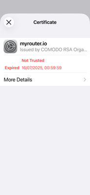

Forgot to mention when my
iphone tries to connect to the router I get an error message about a security certificate not being trusted
