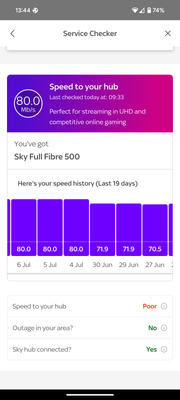

We recently upgraded from Super fast 80mbps to Sky Fibre 500. But since the switch, download speed has been capped at the old 80mbps.
I know this from testing the broadband and looking at the average daily speed. On the old Superfast it was always slightly below 80mbps daily, which I understand to be normal. Now it's changed to 500mbps it's exactly 80mbps like it's being capped at the old rate. Please see the below photo showing exactly 80mbps from the day we upgraded on 4th July.

@Chris4318 It does look like you have been put on the 80Mb/s profile not the 500Mb/s you asked for. I am escalating your post to the Sky team who support the forum who should be in touch soon to offer you a private online chat session to get this sorted. Keep an eye on the forum as if you miss the message just click the brightly coloured chat icon which will be added to the forum pages for you to use.saving a long phone call.

@Chris4318 The check is right on the hairy edge of a possible bad cable from the ONT to the sky Hub, it takes only 1 bad off the 8 cores on it to drop it down to the 100Mb/s speed range, so if you do have a spare cable lying around would be well worth swaping it over!
Plus one other thing, the hub has not been set to fast ethernet on it's setting's as that would force all the lan ports down to the 100Mb/s range!

I understand there may be other issues with the router & the cable. I just find it suspicious that our old rate was 80mbps and that's what we're getting everyday since the day we changed to 500mbps and it's exactly 80mbps. When we were receiving 80mbps Download speed it was always 70-something, it was never exactly 80mbps. This to me is very strong evidence that it's being artificially prevented from going beyond the 80 and that it something to do with our speed profile.
