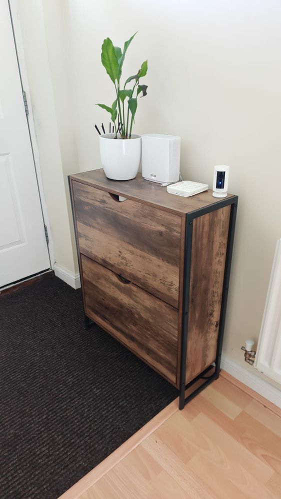

@Raving51 I'm in a 12 year old house with the ONT in the hallway... not the best position for us but not in a cubboard thankfully. My partner and I tried to get creative and so the hub is hidden behind and at the bottom of this shoe storage with just the XT9 on top to communicate via WiFi with the other nodes. Works perfectly and fast.
@Se4 I hear you about having to purchase further equipment when the previous system worked OK. Maybe think of it in t this way- a DIY mesh system (particularly in AP mode) can work with any broadband provider (if and when you decide to change). Also your mesh system can be designed to be much better than anything that ISPs such as Sky can supply. Finally, depending on the equipment you purchase, you can have greater flexibility, control and tinkering of the network as suits your needs.
