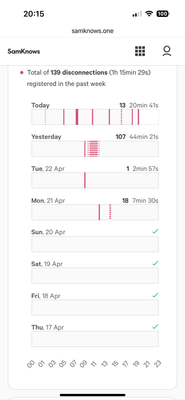

Over the last few days I have been experiencing a lot of disconnections to my fibre which is becoming increasingly frustrating I haven't changed anything to my setup could these be router or line related

@darryl2012 I would add to @peter-marlow+1966 's questions please.
What colour Sky hub do you have black or white?
Is that report being generated by a Sam Knows white box directly connected to a LAN port on the hub ?
What other activity if any was running when the "drops" were recorded?
Just trying to understand the report you posted

I have a black sky hub box and yes I have a Sam knows white box connected directly to a lan port on my sky hub
