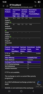

If you enter you full address into the following checker and post the resulting table and the first three lines of the notes after removing the reference to your address forum members can tell you excatly what type of line you have. Openreach Checker

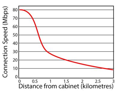

As @Chrisee said, each broadband circuit has to be on a separate phone pair (but can absolutely be in the same physical bundle: further upstream either 50 or 100 pairs will be in each cable)
For FTTC, broadband speed at an address is almost entirely a result of the copper line distance to the fibre cabinet, not the 'shared' bearer use.

@Popityping as @TimmyBGood indicates your broadband speed is down to the distance betwen your home and the cabinet feeding your home. Typically each home is fed by a cable with 2 or more cable pairs one of which is used for your line. What may have happened is Openreach used one of the spare unused pairs in the cable to your property to feed your neighbour's property. Given the cable is Openreach's property they can do what they like and in no way will that use impact your speeds.
