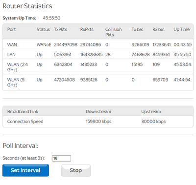

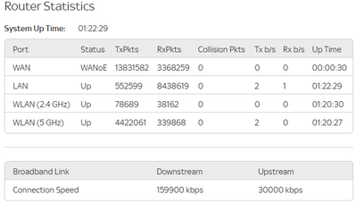

Can you post a screenshot of your router stats?
Message posted on 05 Aug 2025 02:58 PM
Re: Ethernet cable of CCTV DVR to LAN port on router -now causing pkt collisions post full fibre upg
Yep - new SKY-supplied ethernet et al. Followed all their instructions to no avail - their 'solution' is I pay even more for a higher speed service (that I don't need - not a gamer!) to enlist the Sky Max hub and wifi engineer support. With current upgrade/degredation in service (mindful identical setup with copper bar land line) - this is not something I'm keen to take forward!

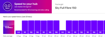

Following my last discussion with Sky on Sunday, we managed 2hours of everything plugged in and working fine with zero pkts colliding. Then went to 16 where it remained until this luncthime (particularly poor stability) - and now showing 28.
NB Hub was replaced 12/7/25 and has dropped below guaranteed average 3 times in this period. It's not so much these figures as the instability that is my concern - 1 minute 150Mb speed, then next nil and then back up to 130/150Mb with no changes instigated by me.

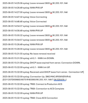

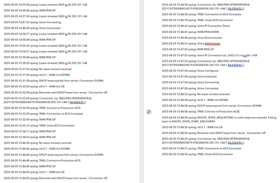

I have also been monitoring the SysLog and wonder if the 'your cctv' is a bum steer (they don't support any '3rd party applicance' using the LAN!, since I also had pkt collisions with just my PC hardwired on ethernet.
From my layman reading, this is regularly seeing the VOiP lost, licence applied for - not always sent - and back up again - IPV6 up/down. We obviously only took up the VOiP with full fibre when our problems started - giving up the fibre to cabinet landline. NB this is despite a full hard reset of Hub/Router and the inevitable 'settling in' in last 3 days.
Any help/suggestions gratefully received.
The syslog of last 24 hours or so is currently:
apologies for small size - I did simply insert all the data but the repeated use of 0805 10 (the date and partial time!) apparently identifies me!

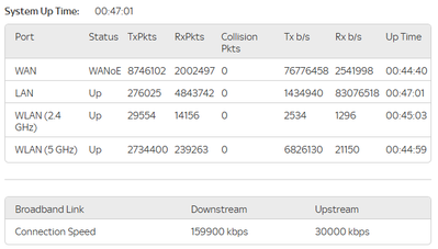

I have undertaken a reset and currently got everything working will all devices I want plugged in, in. I have 0 collision pkts currently and my status log post the reset is okay. Continuing need to connect the phone, apply for licence (presumably from Sky/Openreach vs my devices) and have IVP06 up/down. It is the longer time goes by from the reset that the issues - collision pkts/stability of service - exacerbates exponentially.
Current stats and syslog:

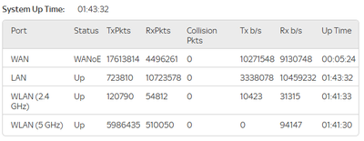

Currently, I have maintained both cables in, 0 collision pkts and full suite of green lights 1hour 45 mins since reset:

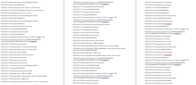

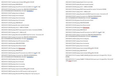

That said, the instability comes from the continual searching/applying for and finding licences. 1 minute 150MB speed, then next nothing/hanging endlessly. (In conjunction with times on syslog - mindful GMT vs BST clock).
In particular, note 15:48:08 syslog: DHCPC_STATE_REQUESTING no valid response received. Falling back to DHCPC_STATE_START_DISCOVERY
It is presumably this continual resetting 'behind the scences' that holds up the signal - even though green throughout (and still 0 pkts). I think the LAN pkts may be something SKY's latched onto to absolve responsbility, when in reality it is the system searching and not being satisfied/continually re-trying so making the situation worse as length of time post reset goes on.
