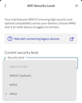

@Leep1505 if you have the Sky Max hub try changing the WiFi security level from woa3-t to wpa2 as a first step. The setting is in the My Sky app in the product options/Sky Max Hub/Advanced setiings/WiFi security.

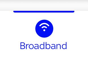

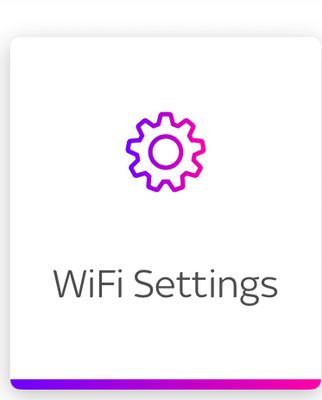

download the Sky App First !!
Hello there peeps this problem with the HP Envy 4507 and probably with most decade old printers is that it does not like the new security setting with the Max box , as soon as I changed it to WPA2 hey presto it worked . my printer has not been working for 5 months was going to get a new one but no issues now just got to re subscribe to HP ink now. Takes 30 seconds. Below is a walk through of what to do this probably applies to any connection issue with older devices or new even
