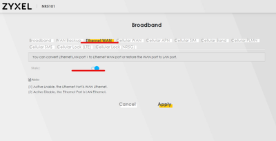

I currently have Sky Broadband Superfast (with a NTE5C socket) and would like to connect it to a Zyxel NR5101 router.
I have had a look at other users issues trying to connect and seem to be getting very different responses.

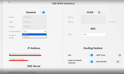

I have enabled the below:
But struggling to understand what info the router needs to connect the broadband
I have seen some forums mention about using option 61 with IAID with the first 8 digits of the MAC address and DUID with "7c4ca5123456" but this does not seem to work
Can anyone tell me what I am doing wrong and if this is the correct way to do it?

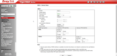

So I've changed my router to a Draytek 2865Lac. The line seems to be sycned but looks like I'm missing authentication details.
Can someone let me know what authentication details I need?

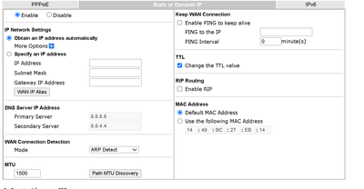

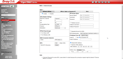

@JackT97 Are you in the UK? as Sky use MER. In which case you need to be using the tab MPoA / Static or Dynamic IP using the settings below:

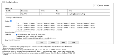

You also need to populate Option 61 within DHCP Client option as per
My screen has additional WANS as i have a Draytek Vigor 3910, but you should see the DHCP client Option button under WAN --> Internet Access. Make sure you have the correct WAN selected
