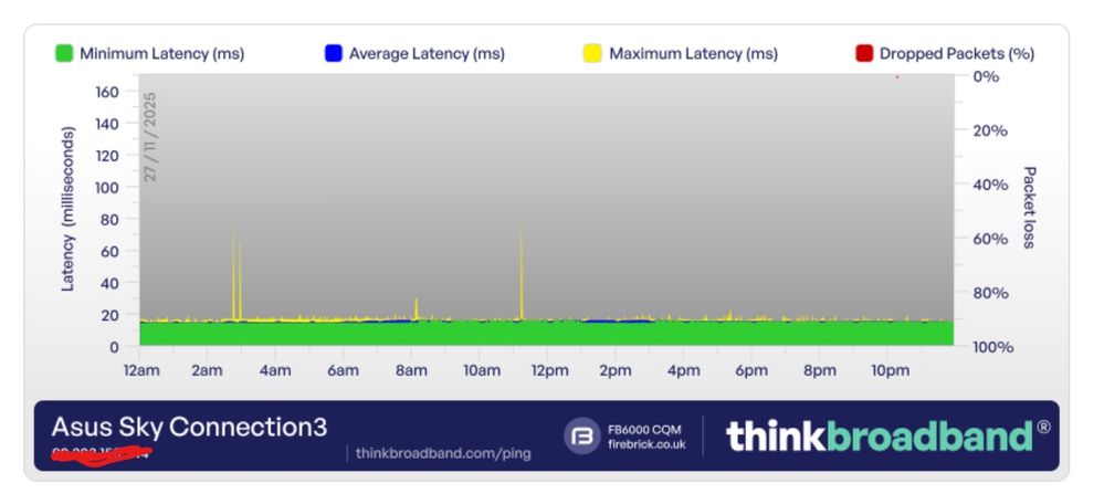

@Wayne+Chu Sky will reject your ping plotter, what where you pinging, even a BQM run against the sky Hub is usefull but there is a 50/50 chance that the delay's are all inside with response. Copy of a BQM run against my Router with Everything connected, so when the picture clear's for viewing you will see, the picture will show a packet loss as i was setting up the sky Hub back on the connection to do a FW update to it!
BQM with no stops
BQM swapping Hub over!

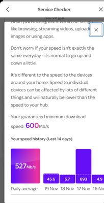

Appeiciate the responses but in itself it doesn't help solve the issue, the image below is from the MySky App. Also even disabling everything in the app for an hour other than my phone do not appear to improve the signal, I truly believe I have exhausted everything I can do, also my home network is no different now to the previous 55mbps connection other than the max hub which I am on the second one.

Was pinging Googles DNS Server 8.8.8.8

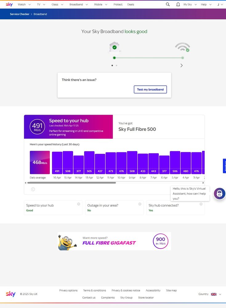

@Wayne+Chu Does not matter your Service Checker is showing you MAJOR issue with the Fibre to the Home connection, why did sky not look at that!!!! Even a bad cable on the ONT 100Mb/s would be the drop down to! Not using the sky Hub now but when it was on for testing the picure is below when it gets cleared for you to see!
What sky saw back in Mar/Apr time!
