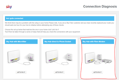

Thank you for your reply @TimmyBGood. Well, I took inspiration from this diagnosis screen that came up the first time the router was connected and just needed to be reset.
My guess is that the modem in this case is acting as the gateway and the router is just "extending" the network.

That illustration is for an FTTC connection using an external VDSL modem (typically a rather antique Openreach Huawei HG612 model) rather than the VDSL modem built in to a Sky Hub.  I'm not sure why anyone would want to do so, particularly as the Huawei hardware is long out of support, but it's an option.

No, in this case the modem is handling the VDSL - ethernet signal change: it's the ISP router doing broadband authentication, gateway WAN-LAN, DHCP, DNS and maintaining a routing table (as the name suggests)
Using a separate modem like that is essentially obsolete for mainstream ISPs but can be required where a subscriber chooses to use a third party cable router model which doesn't have an integral modem.
