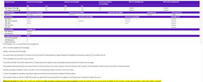

New subscribers in an area will generally be put on fttp where it is available
Could you enter your full postal address and post the table and notes at the bottom after removing your own address from the image

Thanks for the quick response. Here's the details.
I know that a stage 1 installation means the cables should already be accessible outside the house, so OpenReach should just need to splice them into a CSP at the front of the house then run it to the ONT that they will install in the house.

The served by 2.5 plastic duct type 56 does maybe imply wayleave from the landlord if the duct doesn't lead up to the boundary of the property plus planning permission from local authority to dig up road

Also if they are flats the sdu single dwelling unit should normally read mdu multiple dwelling unit where a openreach usually place an mdu drop box above each flat
