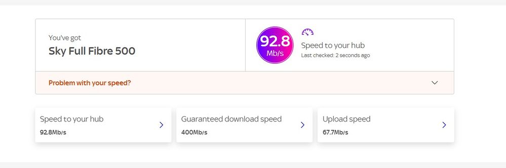

I have a "Sky Full Fibre 500" plan and a guaranteed download speed of 400 MB/s.
However whenever I run a Service Checker speed test from the Sky website, it never shows more than 95 MB/s. I've tried to use the "call us" option following the speed test, but all it does is send me an sms message to run the test again.

@Sandeep2025 With the figure you are throwing up to the Forum, you are on that hairy edge of the 100Mb/s speed off a possible bad cable from your ONT to Port4 of the sky Hub wan, so that is worth a look at, also what is that 30 day Service Checker history look like, Broadband and the > to expand and see, at least it is saying that you have the FF500 product!
Takes one bad connection or cable pin to drop you down to the 100Mb/s, and the cable is Direct from the Hub to the ONT, not through any other device!

I am unable to see a 30 history of the Sevice Checker results. At the moment, I am doing the check manually. Is that option available on the Sky app?
In all my tests the speed has been between 85 to 95, so it seems suspiciously close to the bad cable issue you mentioned. I checked the cable between the ONT and Port4 of the Sky Hub, and can't see any visible fault. I also tried to unplugging and replugging it but it didn't make any difference.

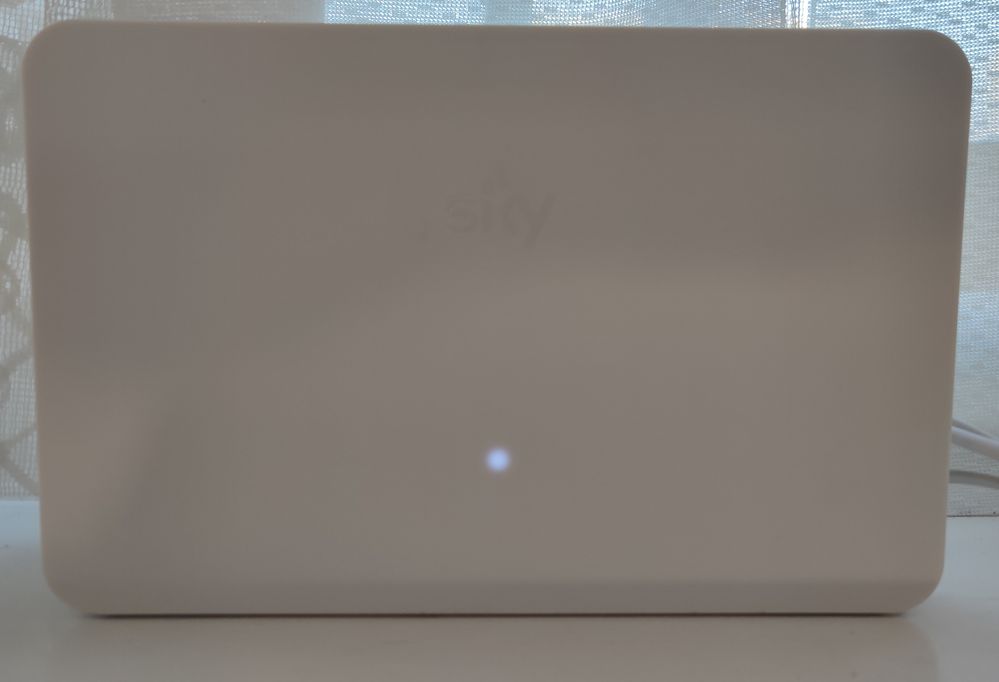

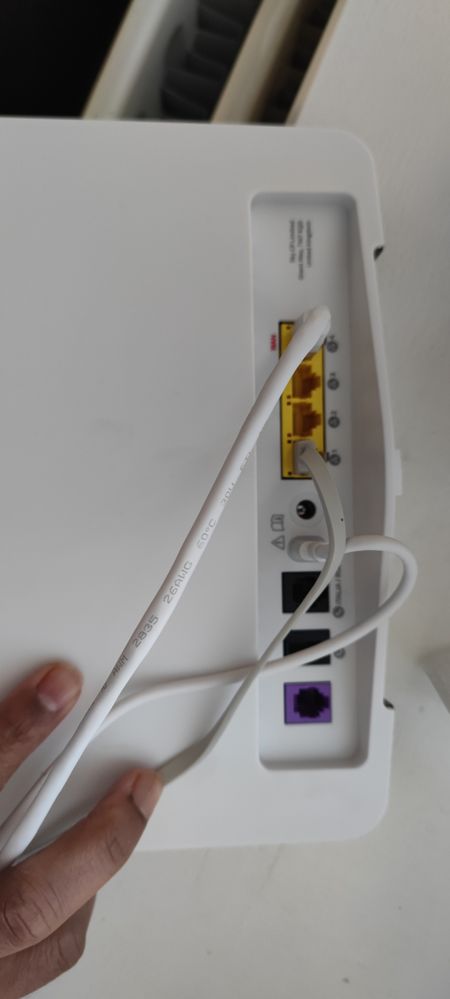

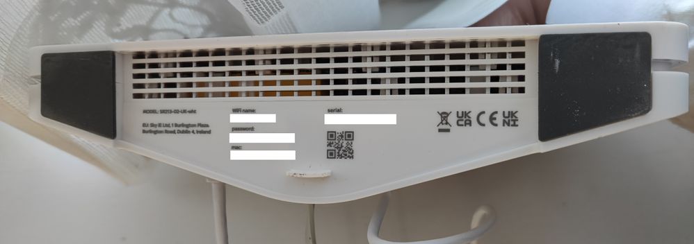

The Hub model is SR213.  I can't see any additional lights near Wan Port 4 connection. In the front I see a constant white light. I have taken pictures of the front, back and bottom of the Hub if that helps.

@Sandeep2025 That's ok, was taking the different approach, the baby brother of the Max has led's either side, and you can tell by the colour what the cable connection has synced at, 100Mb/s it's Orange, 1000Mb/s it's Green, but as the unit does not have them then cable swap is the next best thing, there is nothing that i know allows looking at the port link sync speed. Just looked on my Nokia ONT so NO lights on that either!
Do see though you have another Ethernet cable on Port 1 have you tried a swap off the cables to see how it goes that's the whole cable both ends temp test?
