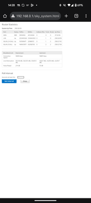

My broadband speeds have dropped from 69mbps to 13mbps.
Sky support say there is no fault on the line and the max speed is 15mbps, I have had a stable connection at 69mbps for the past 4/5 months

@Jenny81 Could you post the router stats again we need to see everything in them as what you posted does not show the whole picture.

Message posted on 31 Aug 2024 02:41 PM
Re: Broadband speed dropped significantly
@Jenny81 I can see that there is a line fault on the connection with a downstream noise margin of 21.4.dB and this normally should be 6.0. But also noticed that you have not restarted your router in over 3 months. Might want to do that re-start and see if the speed comes back and if you are unsure re-post the router stats when you have done this and the forum can look for you.
