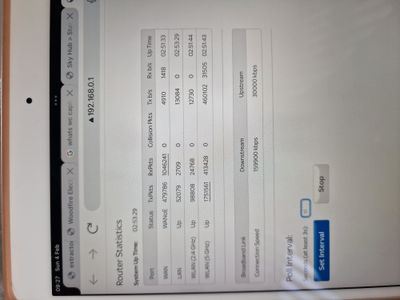

Message posted on 04 Feb 2024 09:32 AM
Re: Broadband goes off every night

@Heather132 your hub restarted some 2 hours before you took those stats so doesnt show us much beyond thst fact ubfortunately.

@Chrisee That's probably my fault as I reset it this morning just in case it needed to reset after changing the settings on my Sky Q box. I was exploring every option.
I will try it again tomorrow if I have the same problem tonight. Thank you for your help.
